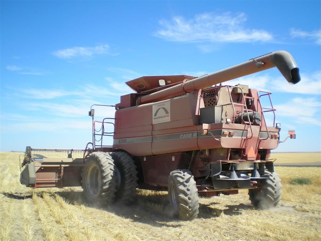

Here are all the pics of the CIH 2388 that we rented this year for harvest. Enjoy!!!!
We cut about 300 acres of spring wheat this year that had the 2388 going as as fast is it could go in second. As you can sort of see it got pretty dirty. We seeded a new variety of spring called Eden which is a club wheat.
Here I am having to wait as my dad unloads the R72.
The two machines cutting WW Eltan.
Here is the Case cutting right before sundown.
My dad spelled me for couple passes. He wouldnt admit it but he enjoyed runnin the case eventhough he is a gleaner man.

that is a 12 row corn head weight kit, which with a case is a must. i cant beleive how front heavy those combines are compaired to our new holland. im almost 100% sure that is a tool box for a grease gun and extra oils
Matt
238 Posts
I think you are right about tool box fordboy. The JD combines we get from Machinery Link always have tool boxes for that sort of stuff. I like how it is out of the way on the Case. All the stuff on the JD is very easy to knock the crap out of your knee when fueling up and hooking the electric lines to the battery for the fuel pump and just general walking around up there.

Nice Photos is that box on the rear platform fuel tank or tool box
I don't know. But it's a really poor place for a beer cooler.
