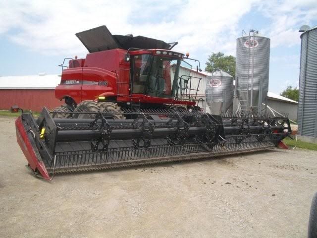

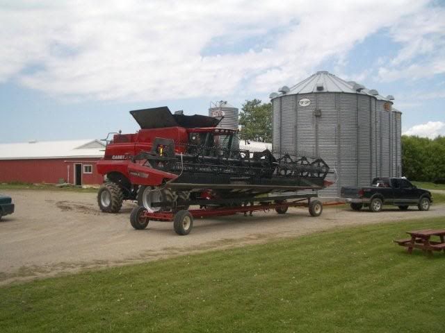

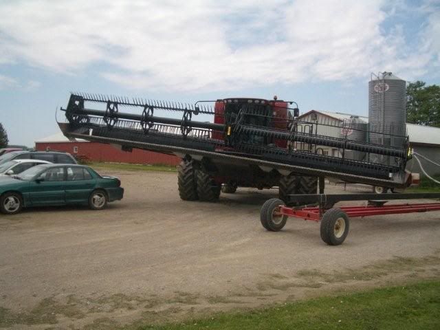

Finally got the draper head home and wanted to make sure everything was going to hook up to the new combine since the head was coming off of a 2388. Snapped a few quick pics but didn't have a lot of time as I'm heading west Monday to start cutting wheat later in the week hopefully. Hopefully find sometime to get some action shots in July when the crop is ready.
Not likely going to be having any cars drive under me when moving because there's not many places you can move in Ontario with that big of a head on the machine but cool to know it can be done.

Nice machine! Really like the new style.
Eric
Can't wait to get ours... won't have the electric extension but that looks nice...
hopefully the new 3408 corn head comes right along with it... or before is good too!!!
what other goodies did you get on that... also what all did you do to the draper so that it would hook up?
The combine is pretty well loaded, only things I can think of that it doesn't have is the 2 speed feederhouse, the leather seat, and any autoguidance.....just yeild and moisture. Other than that I think it has it.
Not sure what all they had to do to hook it up. The head orignally came from Elbow Lake MN where it was ran on an 8010. The guy who brought it to Ontario put it on a 2388 so had to convert it over for the smaller feederhouse faceplate. He added the single point hook up to his '88 so I don't think they had to change much there but I do know they had to do something with the electrical. It was nice though not having to wire in an extra switch to change the knife angle. There is now a button on the back of the joystick you push and hold while you press the fore/aft button and it adjusts your knife angle.

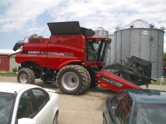

Great looking combine, mx110. What size dual tires are those? (They look like 520's) Is floatation/compaction a big issue where you farm?
MX110, great looking machine, good luck with it! Give us the full report when you get it in the field
Tires are 620-70R42 fronts and 600-65R28 rears. We went with bigger rubber because this combine weighs about 3000 lbs more than the 2588, it holds 70 gallons more fuel and we're putting a 36' on it as opposed to a 30'. Compaction is always an issue.
