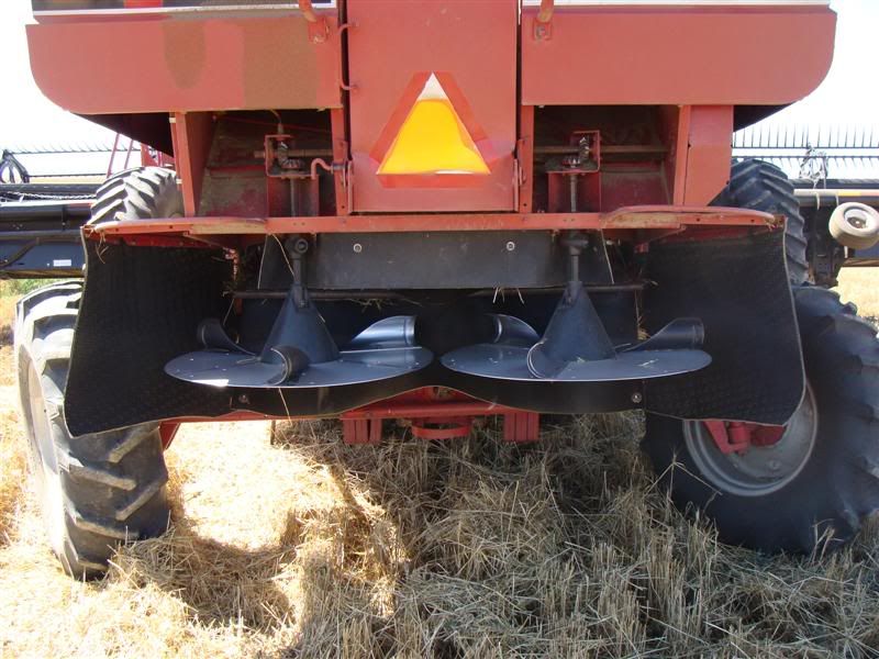

Here's what we did on our 2388:
The original skirts were torn up pretty bad after we put those curves steel bats on the spreaders. The bottom skirt under the chaff deflector is a factory piece (the original wore out), and the side skirts are a bed mat for a Chevy S-10. We picked it up at the local farm supply store; probably cheaper than factory skirts and there was enough left over for some other project.
They worked fine until we got to sunflowers, then the tall stalks kept knocking the skirts into the spreaders. Not cool. Then, one day cutting corn, they got knocked into the spreaders three times in the space of an hour. The wind was blowing about 40mph at the time. We'll probably take them off to finish flowers, then I'd like to modify them before wheat harvest, as I think they kept the spreaders from throwing the straw as far as they could.

When we bought our 2588 our dealer made a piece behind the curtain that goes all the way down out of steel. We haven't had had any problems with it getting in the spreader. Maybe I'll get a pic tomorrow.

Here is what the dealer put on. We have had zero problems.

Thanks, redsteel. That doesn't look too hard to fab up.
