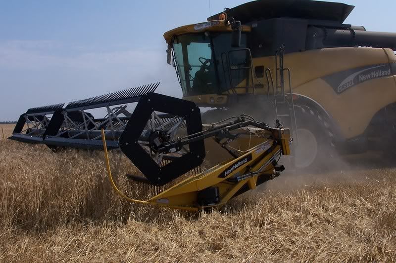

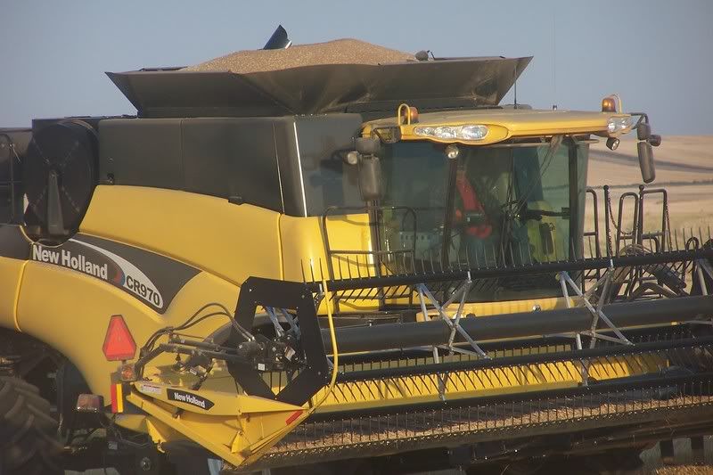

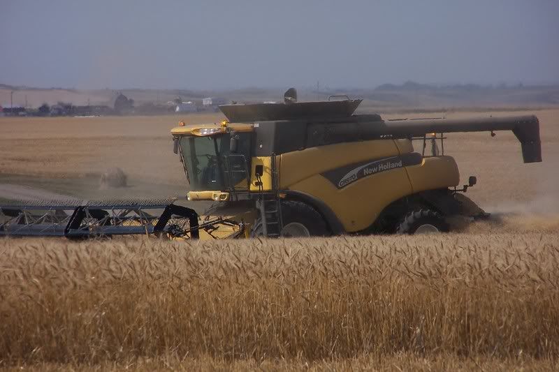

They both have their strong points. The Deere has the cleaner sample. but we might be able to improve the NH with more tinkering with adjustments. The NH is quieter and has a nicer cab. We like the electronic transmission in the NH. No reefing on the big lever to shift like the Deere. The new 970 has more power and is now even with the Deere in the field where as last year the previous model lagged behind. These pictures are taken in South Central Alberta near Drumheller.

Its about time you posted pics of your NH..:) J/K Sweet pics. On the one that is a little blury though..it looks like the reel is going a 100 MPH. Ahh who cares..still a sweet combine. Is that a 36ft header? Do you find it was big enough or would a 39/42ft header be more suitable? I do find it hard to believe that the JD has a better sample. Must be the settings on the NH havent been perfected yet

That is a 36 ft. header. We're happy with it. Does HoneyBee/NH make a bigger one? I know Macdon does. The blurry one was taken at twilight. I was about 20 min. too late. I wanted the combine lights but not too dark. We've tried everything to clean up the sample. Rotors are as fast and as tight as possible. Bottom sieve is almost shut tight. Then the re-threshers will plug. We have 2 rows of front fillers in as well as rotor pins and trailing rasp bars. The variety of wheat is notoriously hard to thresh. The JD is set similarly. The 400 hp is a huge improvement.

Yes, you can get a 42ft model. I was just curious if you thought the combine could handle more at an efficiant rate where you wouldnt have to slow down much or would the power not be there to handle it. Im not exactly sure what to tell you on the sample as I have never run a CR. But growing up with TRs nothing can beat them sample wise. I know others know how to set up this machine so hopefully they chime in..as I dont want to see a unhappy customer.

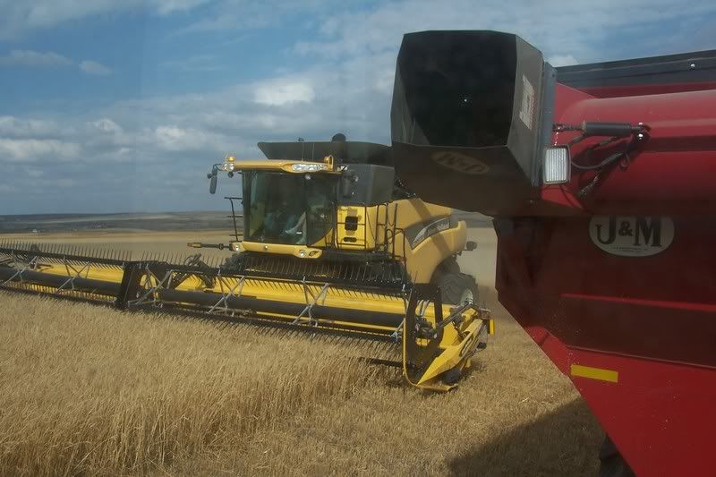

Great pictures of that NH CR970 in action! Just curious, but why do you run two different brands of combines instead of going with one brand? I am not by any means saying that is wrong, but I find it interesting as most guys around here stick with one brand for combines, unless they are tired of one make and then switch to another brand, but trade both machines for the equivalent in another color. Take Care Jason B
144 Posts
The reason is that for years we have leased 1 large combine. In '05 we had a late, large crop coming so last minute, we wanted to get a second machine. Our Deere dealer couldn't source one quickly so we turned to our NH dealer. He brought us a 970 and the rest is history. We've traded since for the increased hp on NH. We like different things about both machines and will probably stay with one of each for a while.
