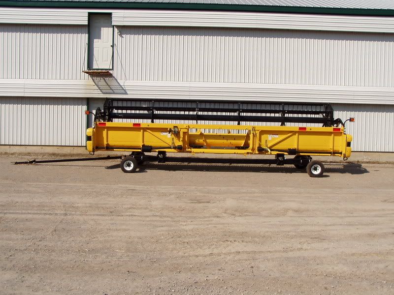

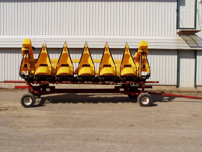

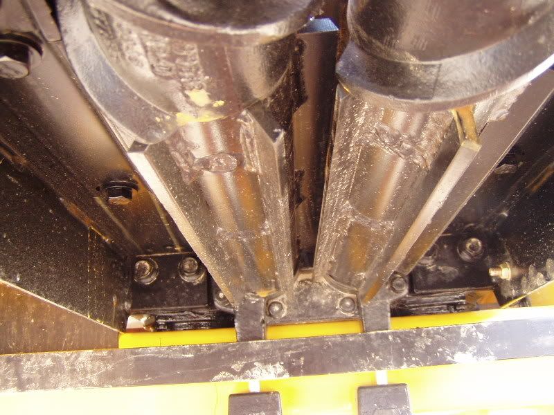

The 940 is just about ready for wheat. We had some problems shifting on Friday when getting it out for the dealer to do some last minute work on it. Mechanic who runs 2 TRs himself said that there were some shims left out on the tranny and put too much pressure on the tranny when shifting. Which made sense considering when he loosened the 4 bolts it shifted perfect. He'll be back Monday. So heres 4 pictures. The combine, grain head, too small of a corn head and the rollers which will chop the stalks. I checked one field today and it'll be close by the weeks end. To bad alot of wheat went down.

Sweet ride. That 30ft header looks pretty small compared to that thing. The CRs have got to be one of if not my favorite. I love the 2388s as well. Just not a big Green fan. Anyway. Thanks for the pics.

That machine looks great....Is there an air reel for that 25ft? Good luck and let me know how the setting up of the machine works out compared to the 88....That 6 row is it brand new or did they keep it from the last machine? Try and post some action shots when you are cutting if you can....We are still a good 3 weeks away here minimum....
NH06
Ya there will be an air reel but its going on after wheat since we'd just take it off for wheat. Ya that 6r is new. So is the grain head. We actually did the head lands after supper tonight. Dealer is coming on Friday to help us set it up for good and calibrate the moisture, ac, bu and all those things so we can keep track of yield and moisture and acres for custom work and our own. ALOT different then the old 88. Huge difference. Have to get use to having all the head functions on the "Multi function handle" as they call it. Really weird so far. Really weird.

Sorry. 25ft' Thats even smaller:) Would think a 30ft would be able to be used on the machine. Oh well. I would gladly come up and run it for you guys. Since you arent used to the new cab and all:)
It ran with a 30ft during demo. Ya sure come on up. Maybe I'll learn to run it alot quicker. We should start combining again Wednesday. So pictures Thursday maybe. Friday for sure.
