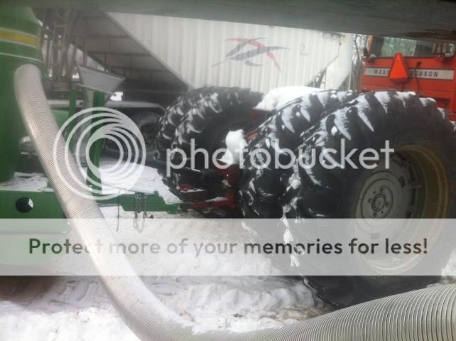

This was out in MB... that's a contract hauler. Gross is 62,500... he could haul 41 metric tonnes legally.
Yes, the farm in MB is sold. Possession date is.... Today!

Wow, Christian! What did he have for a truck in front of that? With my W900 and a set of Prestige trailers, I could haul 43.5 MT. Why is he only at 41MT?

all the guys coming in the yard here for hauling corn or winterwheat load 41 mt, none of them left the yards with 43.5.
1,603 Posts
Mb super b weights on primary highways (except routes that allow 63500)
steer 5500kgs
drives 17000kgs
centre or bridge 23000kgs
rear 17000kgs
total 62,500kgs
alberta, bc and sask allow 24,000 on centre tridem so total weight increases to 63,500kgs
tare weights range usually from 18,000kgs to 20,000kgs depending on truck and trailer spec lode king are heavier trailers than doepker by about 700 kgs and about 300kgs heavier than wilsons lode king aluminum trailers weigh same as there steel trailers. trucks can range in tare from about 7800kgs to 9500 kgs depending on frame, diffs, bunk engine truck make etc as a rule of thumb toba trucks are specced lighter genrally under specced in terms of hp diffs etc and as you go west spec and power increase most alberta trucks are over specced in some minds remeber lighter truck means more payload
