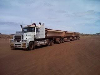

In the drought of 2007 I went off farm and drove road trains from an iron ore mine to a rail head, this truck was legal for a 96t payload and grossed at 140

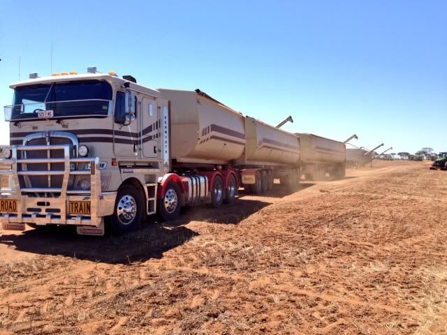

This is one of the bloke carts or our headers western star tri dolly all alloy pay load of 62 something with mass management and harvest concessions
