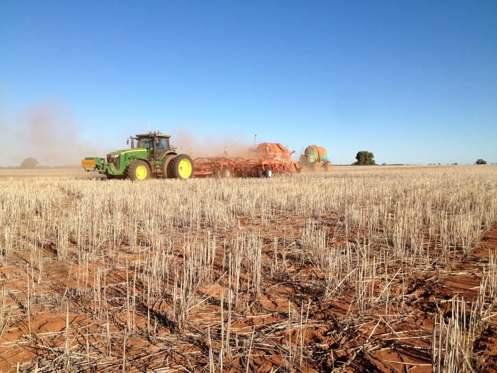

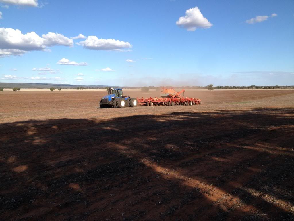

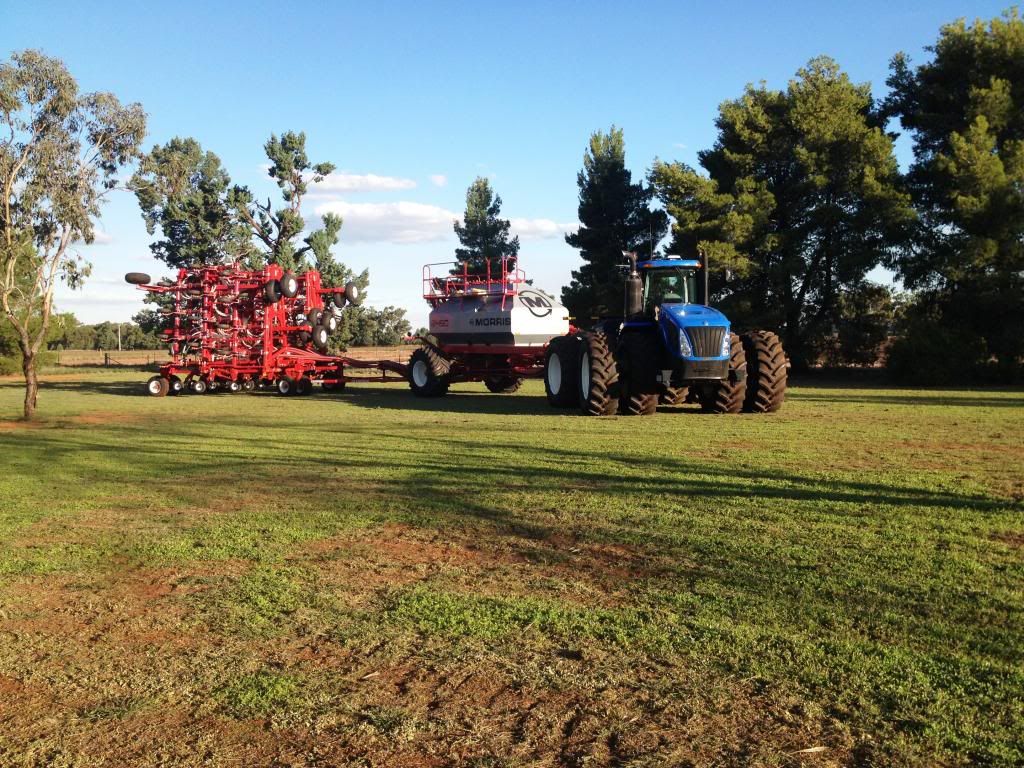

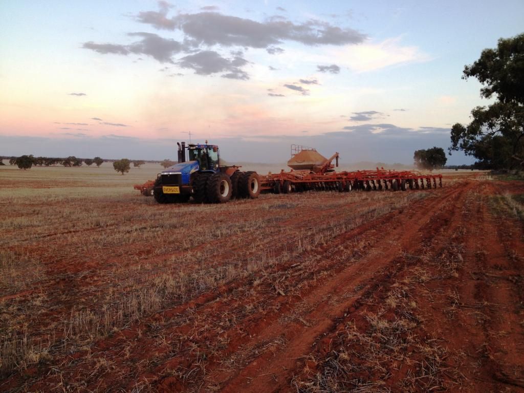

90ft that'll knock back the ac. Thanks for posting pics.

Nice. I really like the new Morris C2 and the 9000 carts. What were some of the issues you encountered with the drills and carts this season?

Issue wise, it was a tough year! Lots of minor issues like hoses pulling out of boots, etc. Our major issue was to do with a third party fan not being able to push the product out on the bigger machines. Went back to Morris dual fans and much better. The other issue was double shooting urea as we had several days with very dewy mornings and nights. The supplied oil cooler struggled to heat the air stream enough to stop it from blocking. We did find on one of the oil coolers that one of the fittings hadn't been machined correctly and oil was by passing which didn't help. We added some bits as per the manufacturers recommendation but made bugger all difference. We fitted the needle valve to create more of a restriction and heat the oil more and that made a difference but not likely enough. We still need to work on this issue.
We are working on about 4.5hp per tyne (Dutch Outlaw in-line double shoot) + 80-100hp for the VRT air cart on the big machines.
These farmers have noticed a drop in fuel usage compared to pulling their previous 60ft machines.

Guys are only sowing standard seeding depths (1"-1.5") depending on moisture and crop. Deepest they might go is 3" which uses a bit more power. There is one guy towing an 80ft C2 with single shoot Dutch outlaw with a 15,500 litre TBH VRT cart with an STX440. Our soils here are not that heavy either in most area's.
All the machines above were on 12" spacing, all double shoot & VRT except the 40ft that had liquid fert and was ground drive.
Speed I think most were sitting 10-10.5kph.
