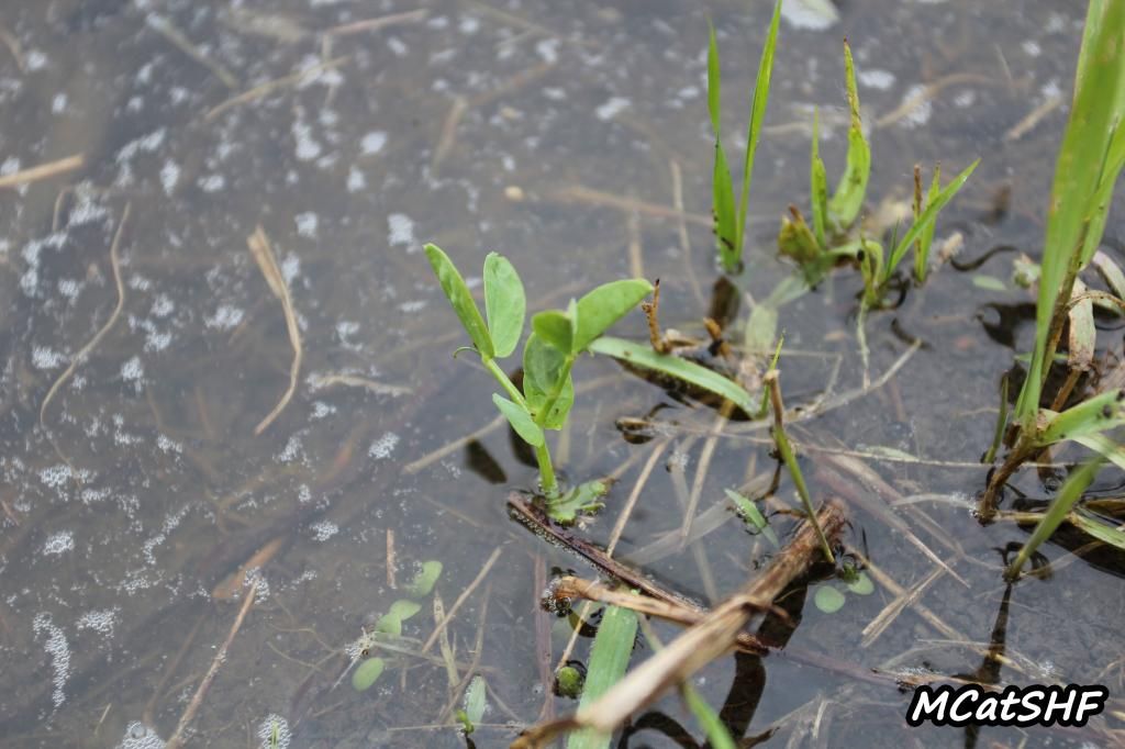

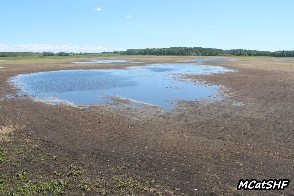

Second time that I tried growing peas & it was a total bust again because of excess moisture.:mad:
My Ranger barley/4010 pea field about 1 week after seeding.
& a couple of weeks later.
