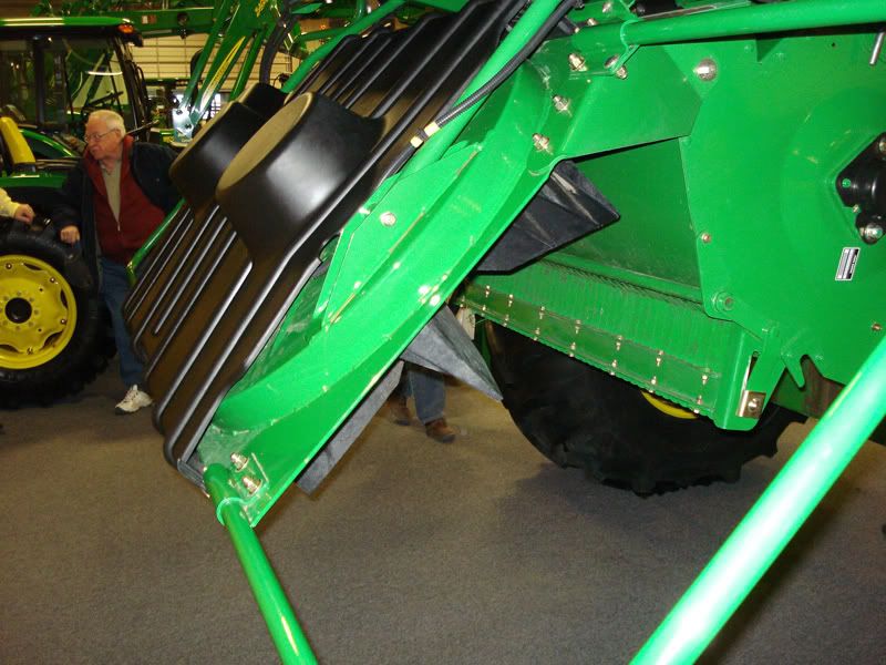

Heres a few from the farm show, it was in the upper position in is alot flatter while in chopping position. Heres few action shots from our farm as well, we had very tough straw in these pictures, it had almost a green tinge to it.
