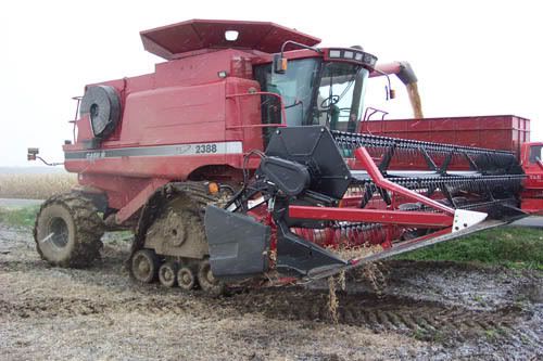

There are a couple companies that make tracks for the 2388 platform. I have seen both a steel track and a rubber track design. The tracks only go on the front axle, and typically look similar to the tracks on a QuadTrac, but there are only 2 tracks on the machine. Steer axle still uses wheels.

Were those on your combine younggun?

Re: 2388 quadtrac?
Tracks are actually smoother an more stable in the mud than tires we run these tracks on a 2188 but take them off when it's dry,ground friction will take your combine apart
Re: 2388 quadtrac?
I saw a set of factory Case IH tracks on a 2388 a couple of years ago at a farm around Quincy, IL. Identical to a quadtrac system from the 9380's but had a gearbox intergrated to improve road speeds. The farmer said there were very few made.
Re: 2388 quadtrac?
I not sure about details but he said it was nearly the same as having tires on it. Sorry no pics but it basically looks like the quadtrac system and the gearbox was in behind kinda hiddden in the framework. Looks almost like a griptrac system in the pic above
Re: 2388 quadtrac?
Wouldn't you wear the brakes out alot quicker from using brakes to turn, or do the rear tires work for turning?
-dan
Re: 2388 quadtrac?
The differential in the transmission is still there, so the rear tires work for steering. There's not much more scrub up front than running a set of wide duals, or a really wide single.
Re: 2388 quadtrac?
I know a guy who installed the tracks form his 9380 quad onto his 21 and 2388 combines. He built a u-shaped fram that clamped to the combine axle then filpped the drive wheel around.
Re: 2388 quadtrac?
If you mean ground friction (scrub) there's a lot more with tracks like I said as long as it's wet their great but when it's dry turning on dry ground is like trying to turn with diff. lock on rwa helps to turn. warning, stay off the brakes, use lightly these hubs an frames on the tracks and 21-2388 aren't made to turn like a cat dozer, have heard of some pretty nasty tear ups
