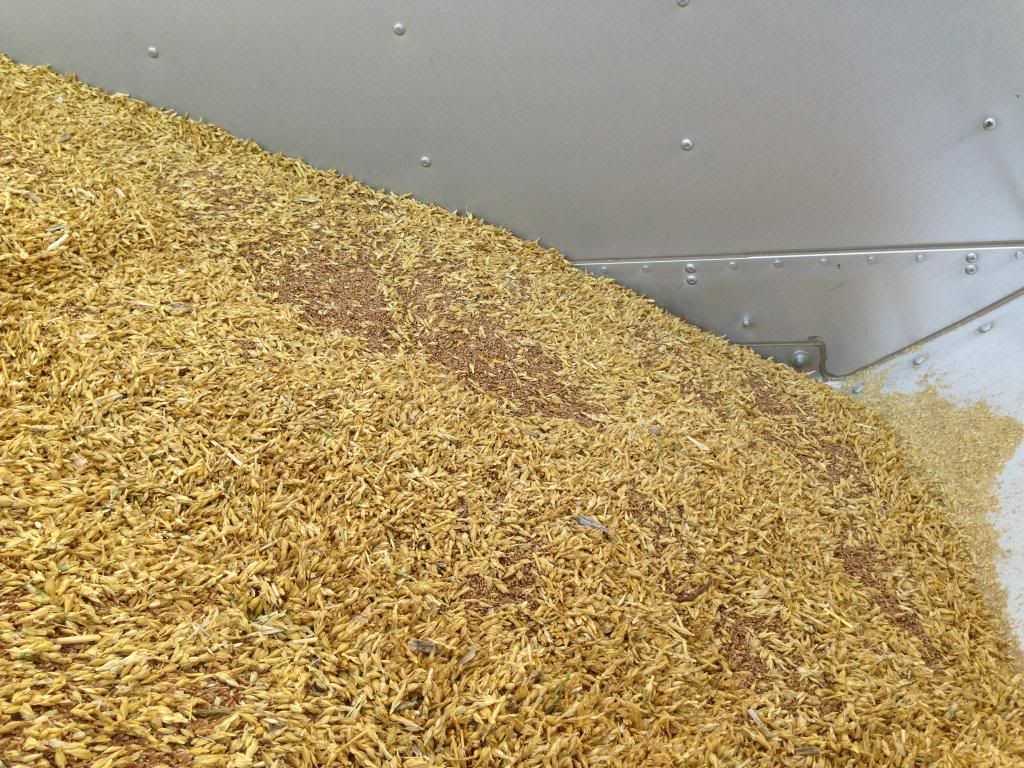

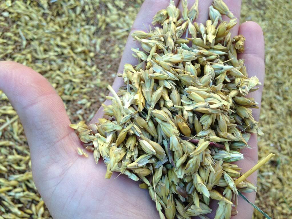

Helping a buddy...Spring wheat 50bu but harder than most years to thrash
He has been having close to 3 percent unthrashed wheat in hopper, :mad:have tried all sorts of rotor concave clearance, rotor speed, top and bottom sieve adjustments with no success, dealer is no help and getting frustrated, rethrasher is over working and causing alarms and plugging when bottom sieve to closed, or top to open...having to run fan up to 1100rpm to stay moving, but going out the back, tried putting veins to slow and still not helping
Reduced speed seams to be the only way to be acceptable:mad: combine loses are also on higher side.... Dealer advises to raise rear of combine to highest setting
I run the axial flow and we needed to put veins to slow and concave tight and rotor fast, been working good with minimal loses and capacity 30 percent better, but no luck when doing this to the Deere
It seams like he has much more capacity and is limited to these issues, it like the rotor is not doing a proper thrash and then rethrasher can't keep up:mad::mad:
What have others used for settings or found to work best in this situation...engine load is 70 percent, header is 45', owner is very upset with the machines to date, and will be sold soon if things don't get better

Well both concaves were level, and one combine in low feed acc and the other high, no difference
One combine has the rotor veins stuck in the retard position and the other when moved to advance made no difference, biggest issue seams to be the rethrasher, as the owner said today, if the combine even sees a kochia or something green your out opening both return doors, that sad..., if he did this once they have done it 1000 times, ulgy dusty job
Dealer advice today was if going into a tough area, close top sieve and run threw it, then open after.... I almost fell on my ass with that reply...
Ended up raising rear of combines to highest axle position to help material stay longer on the pan and not over load front sieve...Another Deere owner had success doing that, and dropped rethrasher load but sample is still over a percent unthreshed
Deere return auger to sieves after rethrasher dealer says needs to be revamped, bottle neck... to small for combine capacity, he replaced bushings, best answer was to reduce speed, chatter box a joke
