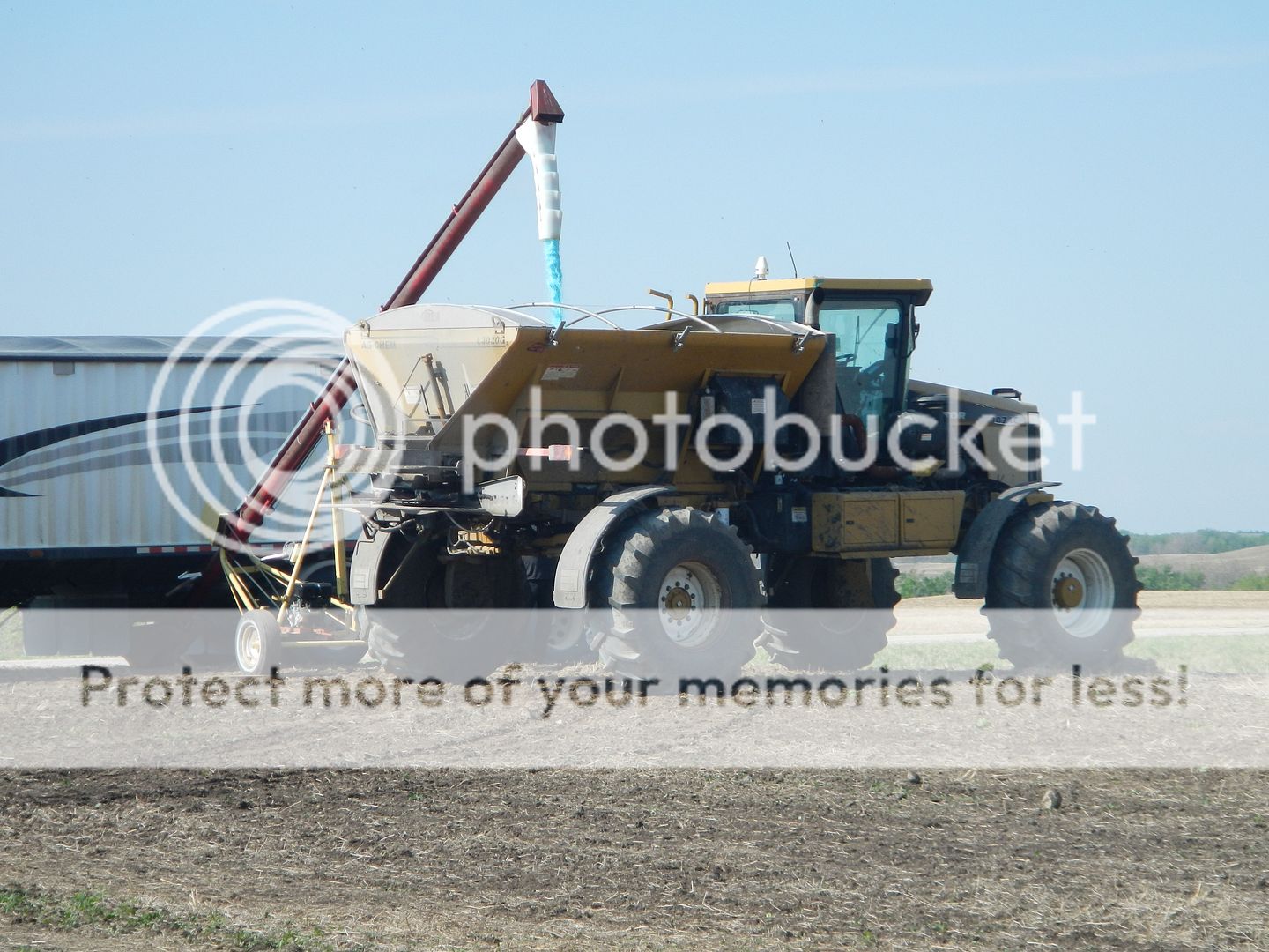

Blair's Ag out applying our N program.... We also put down 20lbs of K with the N... SuperU is what we used.

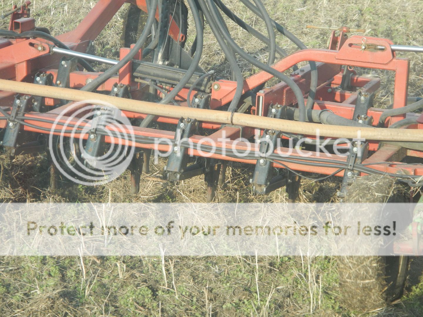

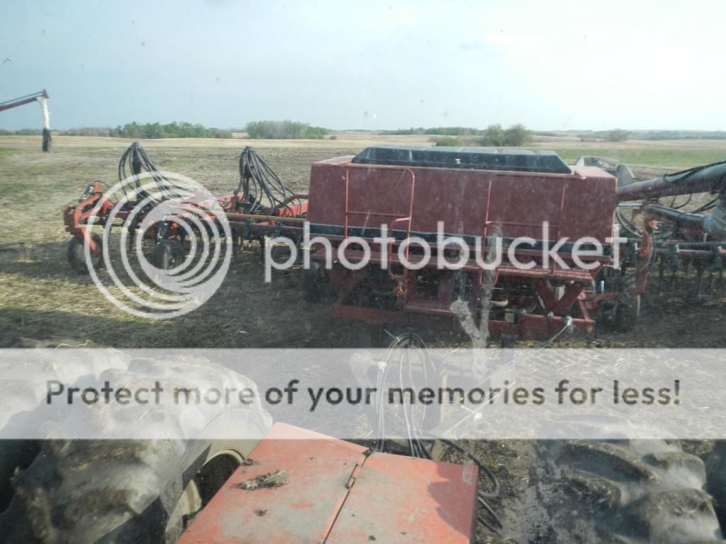

Very minimum disturbance outta this drill.

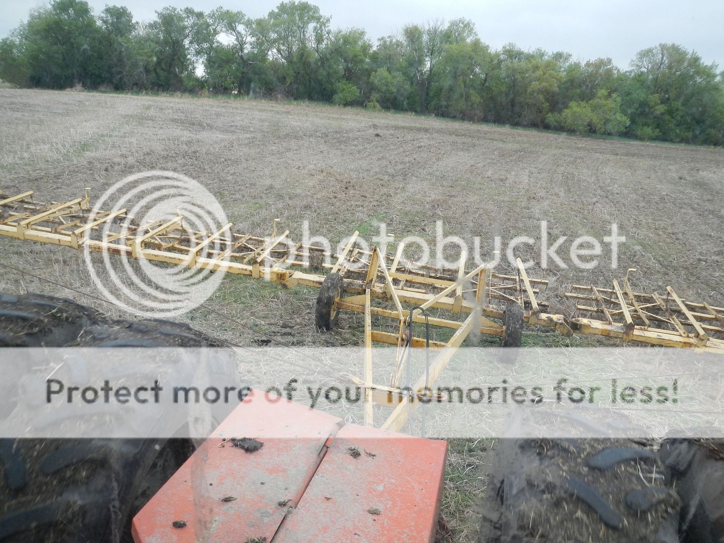

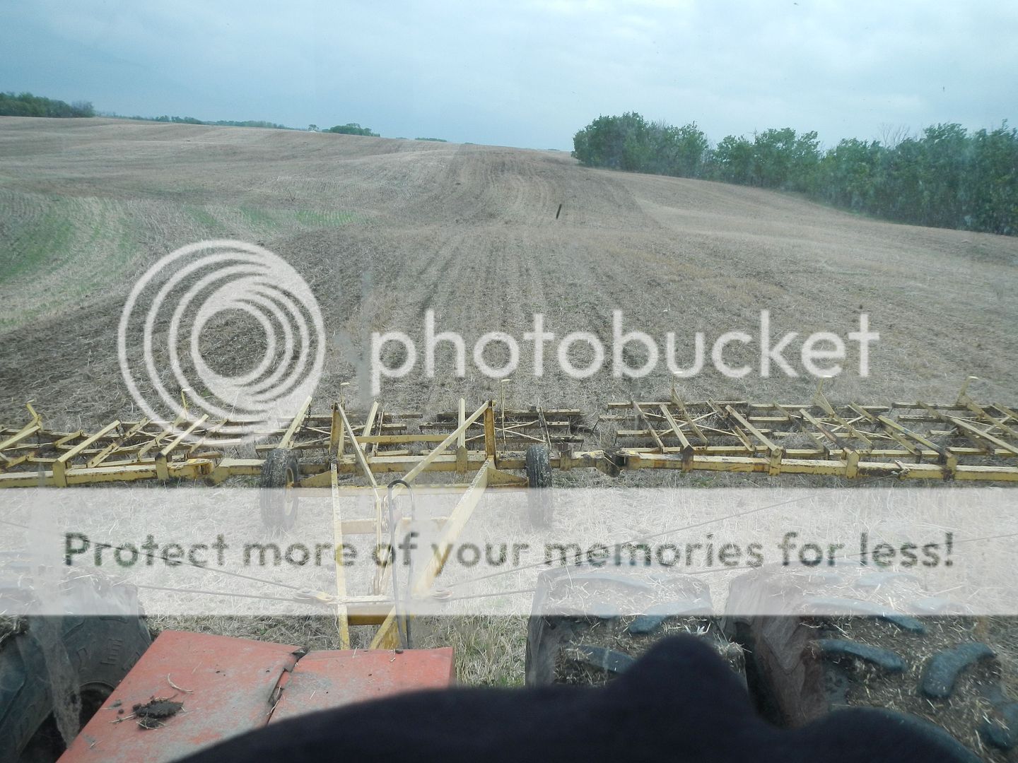

Old harrows... yes, they're not a heavy harrow... but they work well to spread and break up the straw.

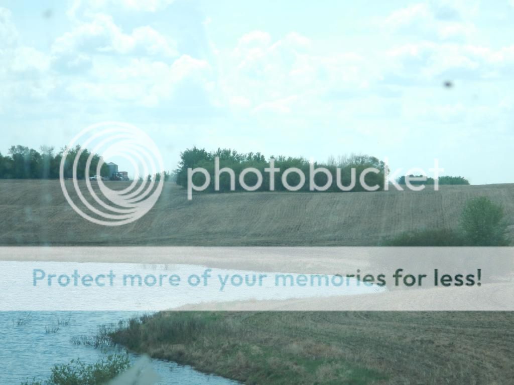

Some hills on this stuff....
and trees....

Christian it sounds like you are thinking of making change to seeding equipment for next year. Your 8500 looks like one of the later ones and in pretty good shape. I thought I might share where we are at with an 8500 and what we have done.
-built liquid tow between cart, N & S in one tank and alpine (orto Phos) in other
-shoot N & S to side and drop alpine right on top of seed. This is a 12" machine, on our 7" only had one N tube on back of each shank
-now we could take fert dividers out of grain tank, now 145 bushel vs 85
-no more dry fert so we built gran innoculant tank using seed cups from 6200
drills and we drop into venturis where dry fert used to go
-to work properly, must be pulled with MF tractor
-these are Gen carbide tips and we had to weld them to the shank adapters, to keep them from tipping down
-only seed no-till
-we farm rolling land with some pretty good hills and this unit tracks very well
-this is a "frugal" unit
Ken A

5,952 Posts
Discussion Starter #14
Thanks for sharing!
Few questions for you:
1. What size of liquid tanks do you have? I.E. acres/fill?
2. Did you set the liquid cart tires to track in the drill tires?
3. How well do those openers wear, and how pricey (if you don't mind me asking) are the GEN ones? I tried getting ahold of someone but left a message and never got a call back... AtomJets are over $80, but they replace the boot too.
4. Is this setup, do you feel, worth the cost premium of a liquid fertility program?
Thanks,
Chris
Ken Adams
1,322 Posts
Chris
1-N/S tank is 1200 imp gal, and alpine is 500 imp
acres/fill -canola, limiting factor is N/S tank size, about 55 acres
-peas, seed tank is limiting factor, about 50 acres (was about 25 acres with fert divider in)
2-cart tires are following dual tires on tractor
3-the carbides wear very well, what wears out is behind carbide. I am getting about 4-5 thousand acres out of an opener (or more), compared to a standard eagle beak that I might have gotten 7-800 acres out of. Paid $35 for these tips last year and I still have quite a few adapters from 7" machine.I have not tried to replace a Gen tip that was welded to adapter yet!
4-don't quite understand your question, yes you pay a premium for 28-0-0 but I think it has advantages. Yes alpine is expensive, but here it (my situation) it works. Our equipment costs are low with this set-up if I do not count my labour.
Ken
