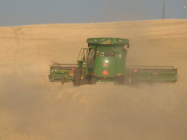

Coming to the end of the cut on a ridge top.

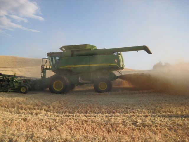

9860 STS w/936D

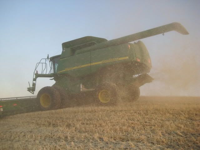

Sometimes you don't always get to unload in the best spot! Cool though.

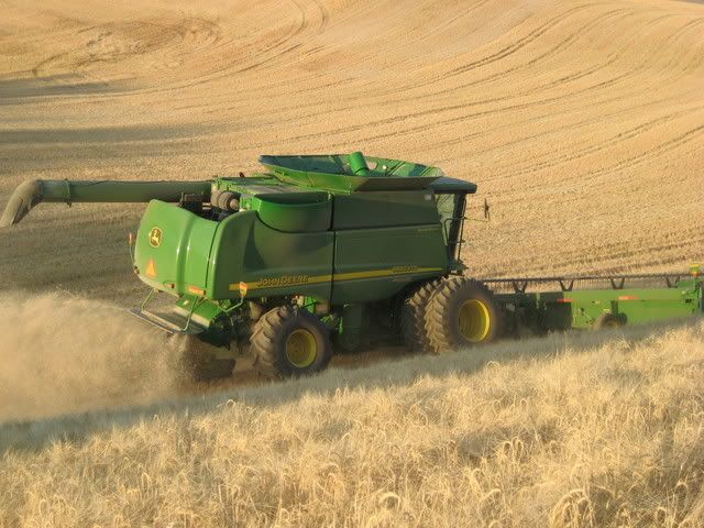

Climbing back up the hill from unloading.
Who says that chopper can't spread 36ft!

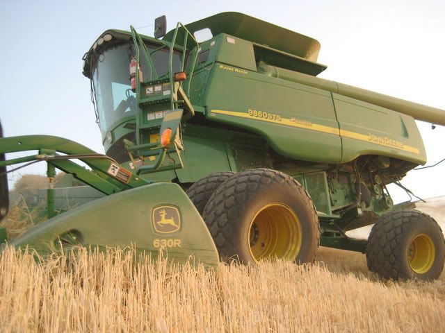

My dad walking along the other 9860STS w/630R.
Head on view.

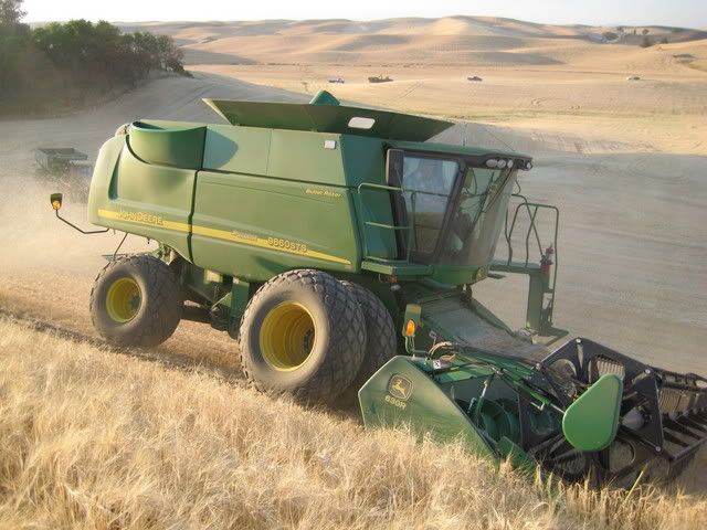

This machine has the turf tires on it for greater stability on the hills.

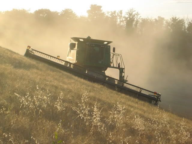

Cutting along the 45% slope.

This is truly amazing! I can see in the latter 3 shots that the combine has not reached its maximum leveling capacity, but is still leaning to the left just slightly.
There's just NO room for error or any kind of a hydraulic failure here. This is most definitely putting both man and machine to some test of skill and reliability.
Gotta love extreme harvesting!

These machines were converted at the dealership. Why use turf tires? Well you see there is more surface area around a diamond type tread than there is on an R-1. Now the angle of the tread at which the tire contacts the ground helps keep the machine on the hills as compared to the R-1 which the tread bars are pointing at the down hill side of the slope. There is really nothing to combat the force of sliding down the hill with R-1 tires except lowering the tire pres.
Hydraulic failures are rare around here. There are built in safety checks in each of the leveling cylinders to prevent an accident from loss of hydraulic pressure.

Interesting comments on the diamond tread tires. I had to find that out by reading the operators manual for the John Deere 6602 and Gleaner MH years ago. Looking back at all the hillsider combines throughout the decades, I've never seen any with R-1 lugs in the first place.
