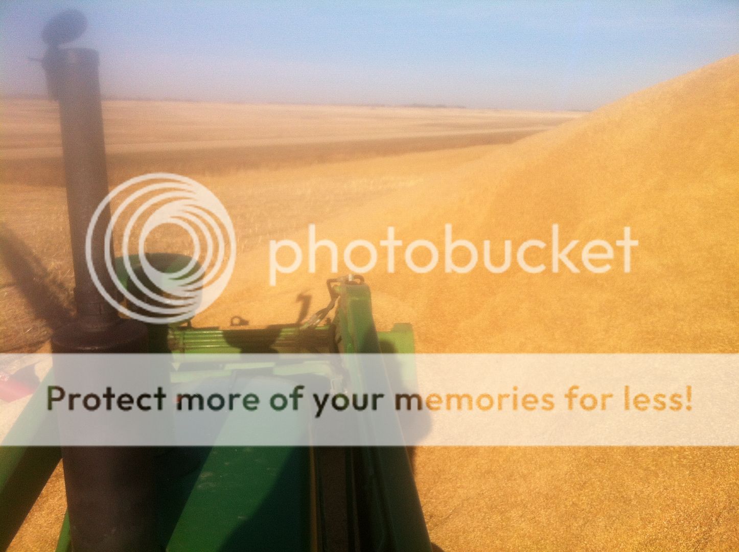

If I have to make a pile, I do it on mowed grass in the yard rather than in the field... too many small stones. At the point now where we've got enough spare bins that I rarely have to since we got rid of the pigs. Made a plastic tarp once to go over a pile. It worked good to keep a big rain off, but had to be removed right away after the rain or the condensation under the plastic was a big problem.

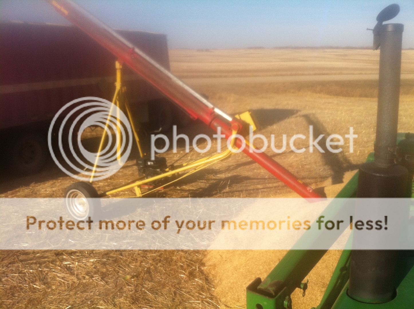

We put those gatco air tubes in seem to work very well we jsut started picking one of two piles of ground and started drying as we are moving a small barley contract. The barley is 18-20 moisture and no spoiling as of yet and been on ground a couple weeks. We had two in some wheat piles (50ft rings) a couple years ago and wheat sat for two years before we hauled it in and only place we had a alittle spoilage (the two piles maybe 50 bushels) was were the tarp leaked alittle. We even have some 15% canola piled on ground with a tube screwed in cause we got no were to dry to yet.
