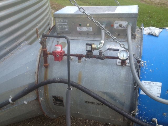

Putting a low temperature heater on that bin may be a solution.
I just got these two that haven't been used for five years fixed up and running today. On that size of bin, 1000 gallons of propane more or less will make your problem go away. This is drying wheat that's about as damp as your oats. The plenum runs about room temperature on a day like today 11c.
