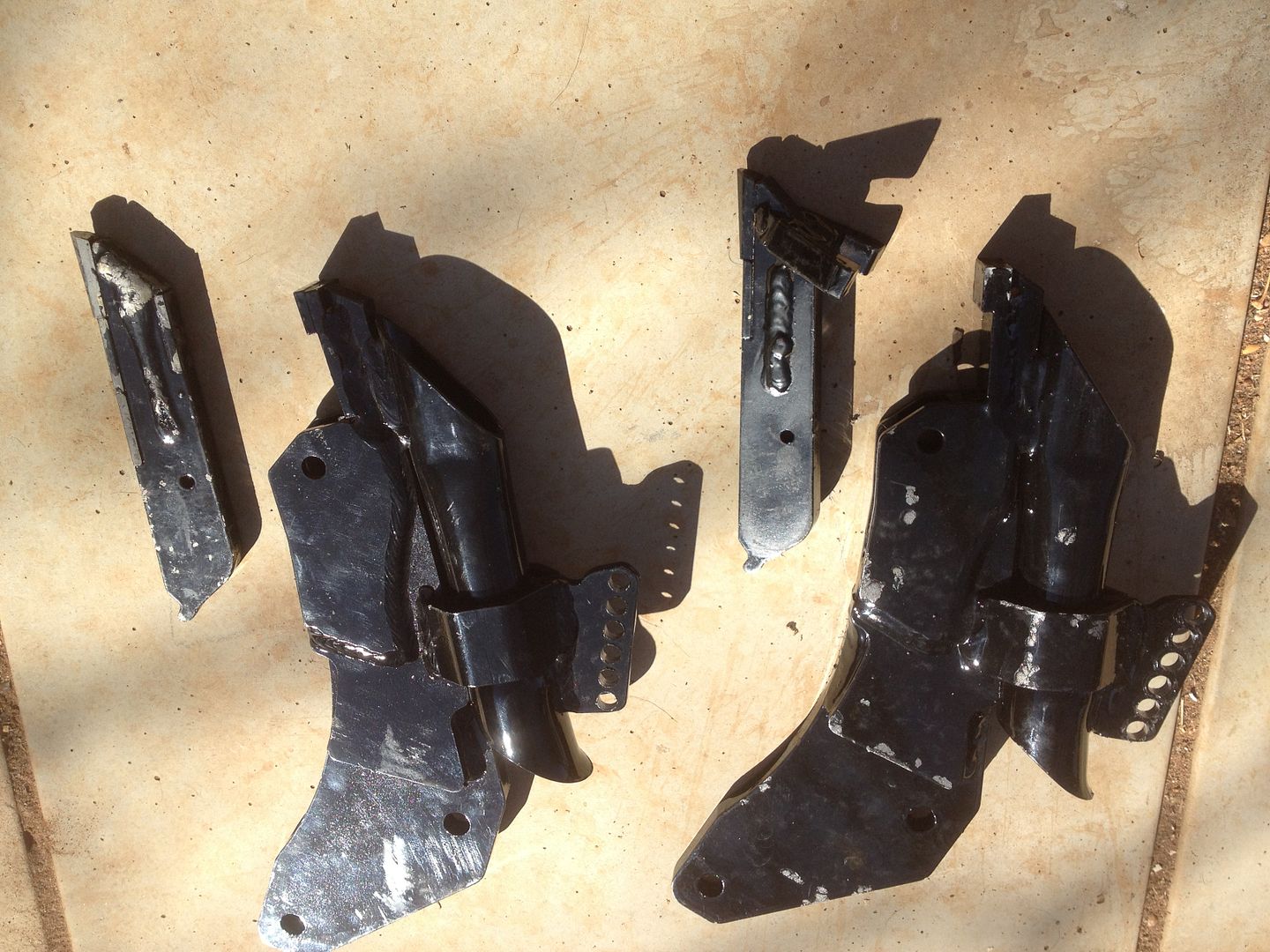

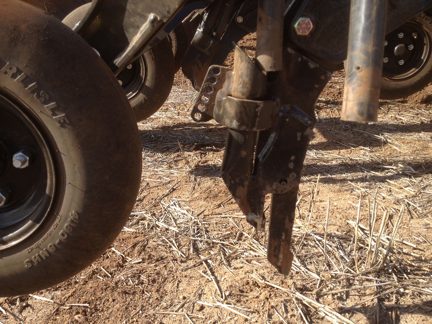

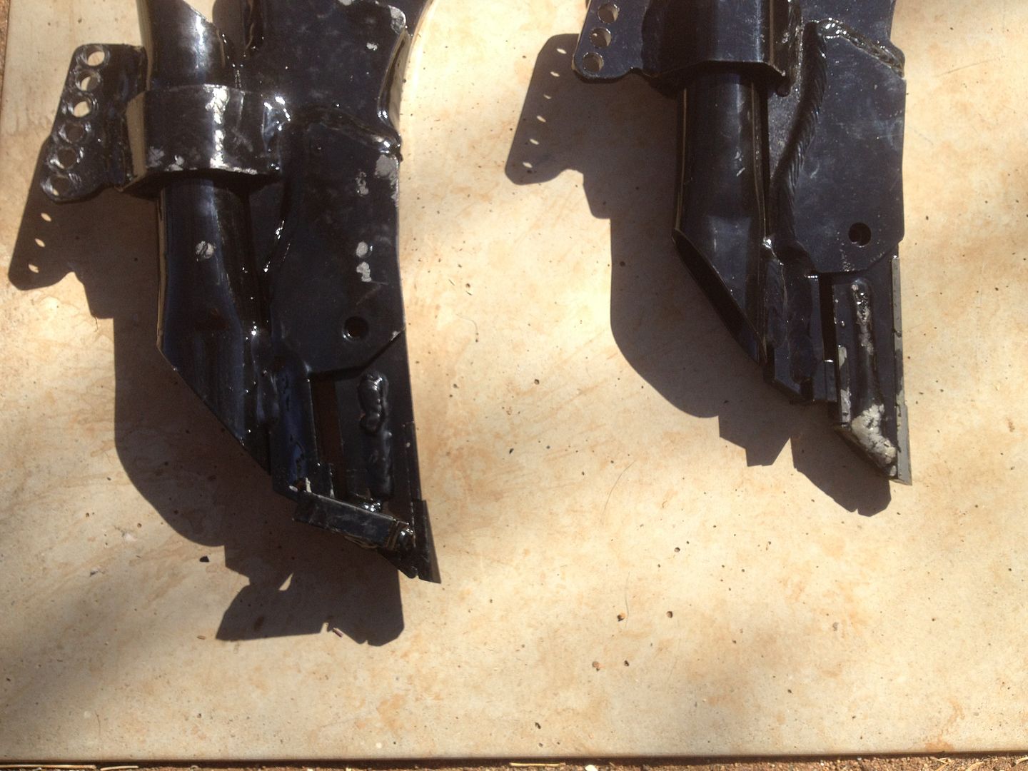

Well, can't get hold of any bourgault openers. Got my hands on the Outlaw series from Dutch today. They look promising.
The last photo is the original flexicoil opener. Above that are the two Dutch openers that I have so far. Both 3.5 inch, one a straight knife point and the other an inverted T. Time to go and see what they do.
Tomorrow I should have the 5 inch versions of these two points.

Keep in mind you have a press wheel that measures 4.8 inches wide and it is what sets depth, the relationship between the bottom the press wheel and the bottom of the opener. One should not run more than a 3.5 inch wide openers. You need a hard un-disturbed surface for the press wheel to ride on, if you carve out a 5 inch wide hole the press wheel is going to keep dropping down which will affect seed placement in a negitive way. With a 3.5 inch you still have some hard surface for the press wheel to ride on and keep better control of the seed depth.

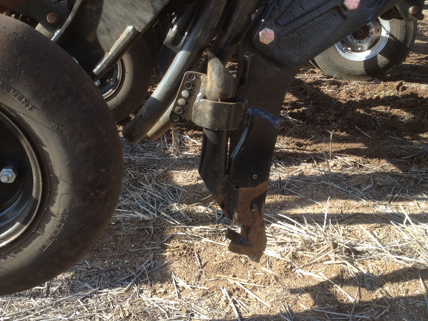

Well........these points make a HUGE difference! They dig very well and keep their depth consistently. I think we are on a winner, they even kept their depth on a hard dirt road! I will take a few pics tomorrow and do more of a write up about them, but just really happy that it looks like we have a machine that is going to do a great job.
Discussion starter · #37 · (Edited)

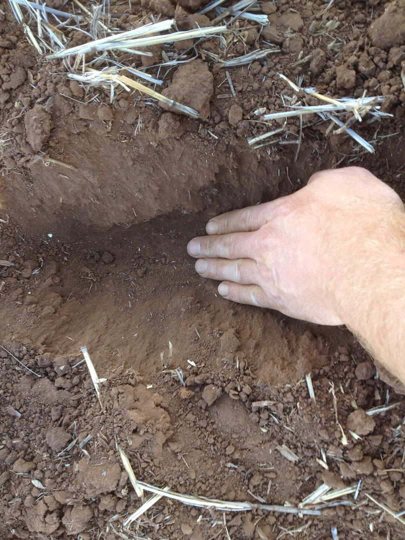

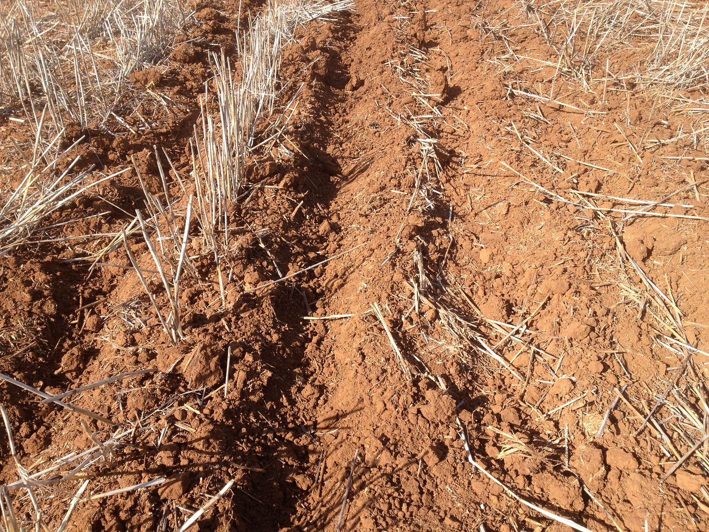

The following picture is a great example of the problem I was have with the Flexicoil points not penetrating. This was done in a hard area of the field which really highlights the problem. You can see in the middle where it hits a harder patch and the openers just ride up. The Dutch openers just kept a consistant depth through ground like this.

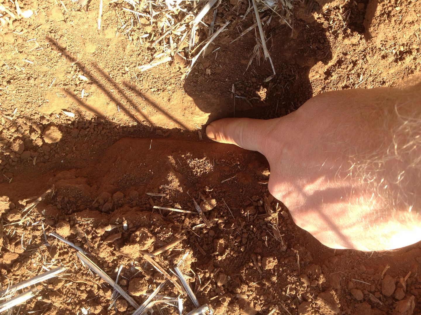

The next picture compares the knife point against the flexicoil point. They should be sowing at the same depth, little hard to see in the pic but the knife points at the bottom of the picture were about 3/4in deeper.

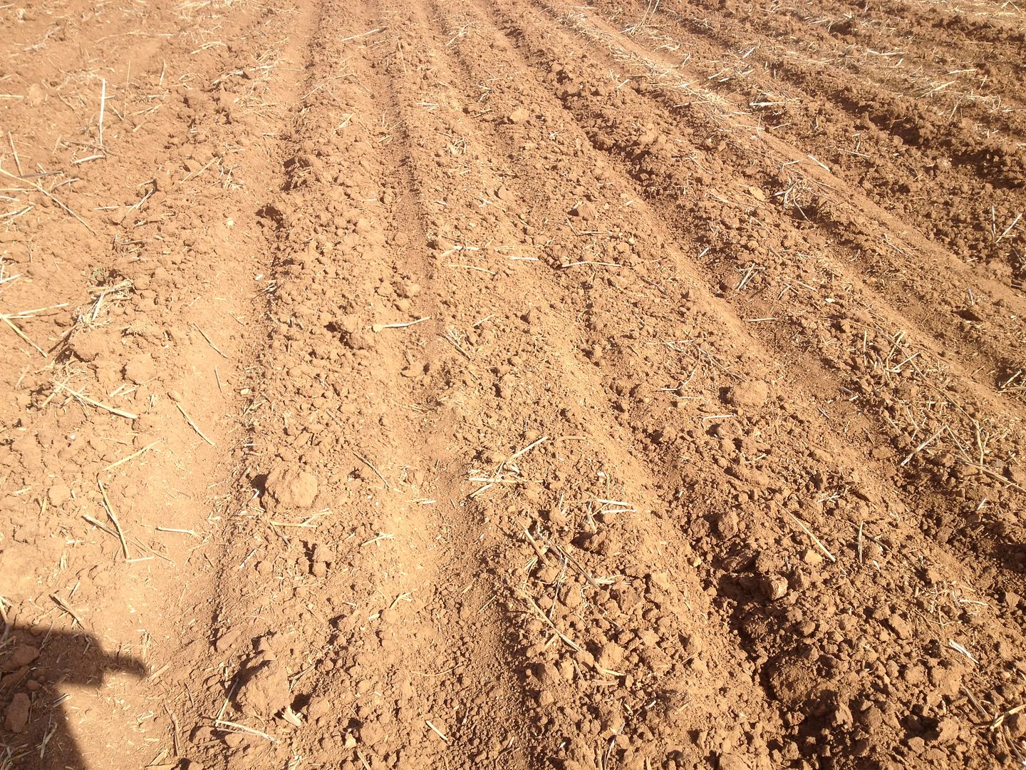

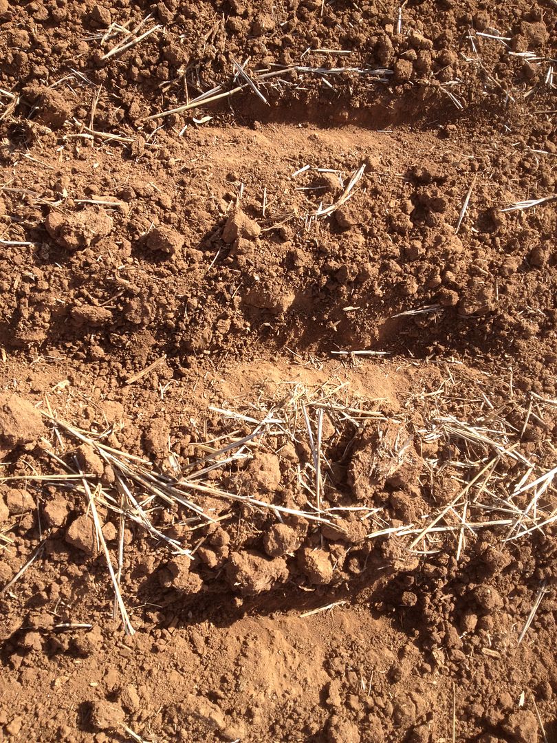

The next two pictures are of the furrow left by the knife and inverted T points from Dutch. Not too hard to work out which one is which. They both dug well to the same depth.

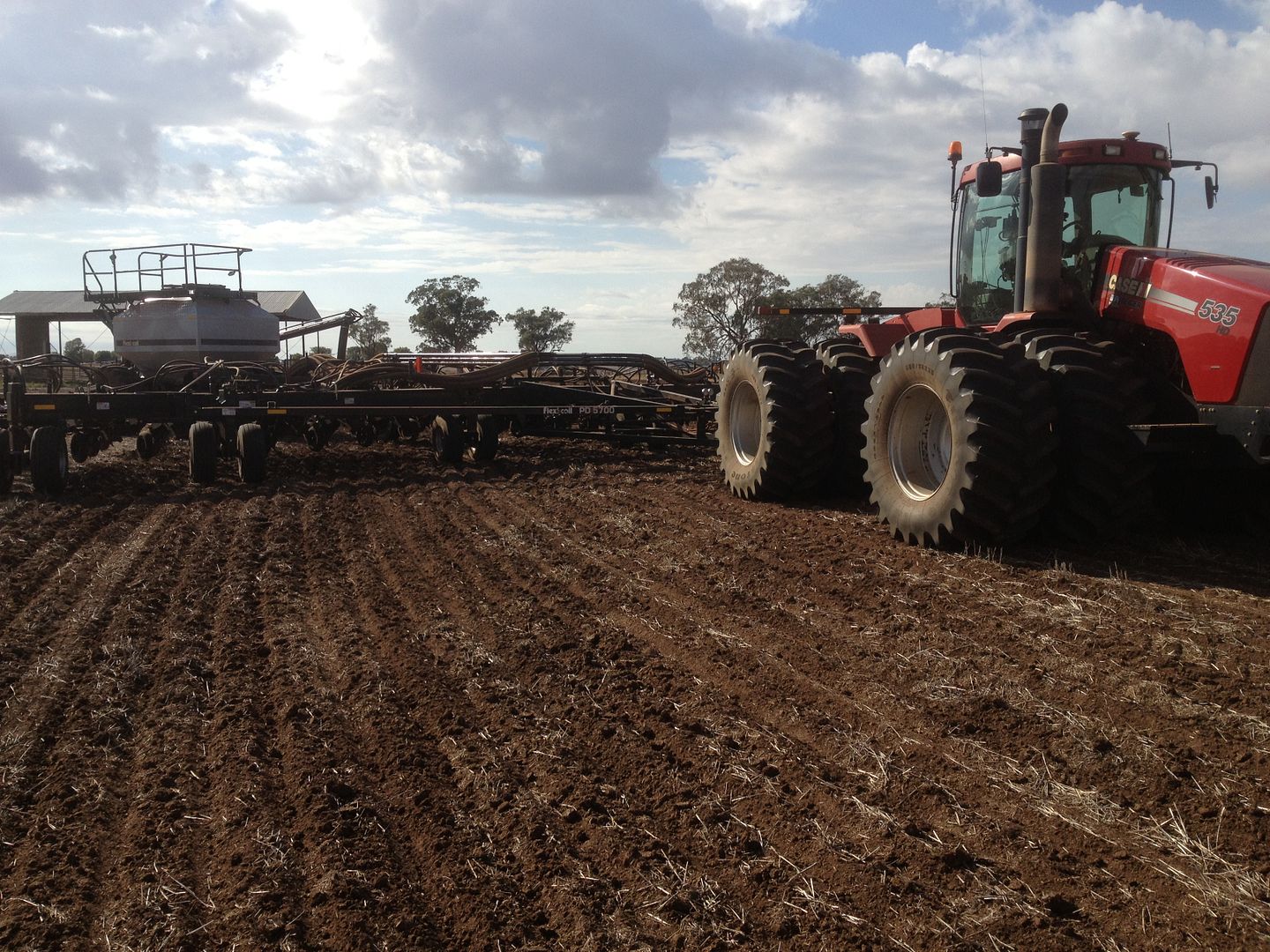

The next picture shows what happens when you plant at 11.5km/h (7.2mph)! The two rows on the far left are the new knife points and the rest are the flexicoil points. They were sowing at the same depth. As you can see the flexicoil rows are nearly completely covered in while the knife points just have the odd small clod in them. The conditions are pretty dry and as such clods were coming up, I seriously think that in good conditions you could probably reach 12.5-13km/h with the knife points before soil throw was a serious problem. The Flexicoil points would only let me get to about 7km/h before throw was an issue in these conditions. To put that another way, the knife points would let me do an extra 8.2ha/h (20acres/h)!!!!! Now that's a big difference!!

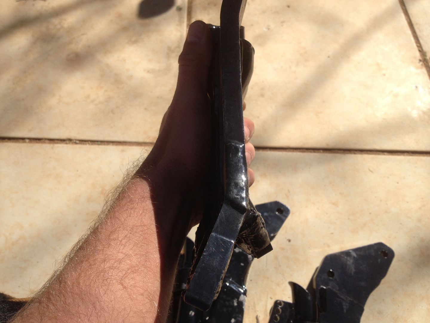

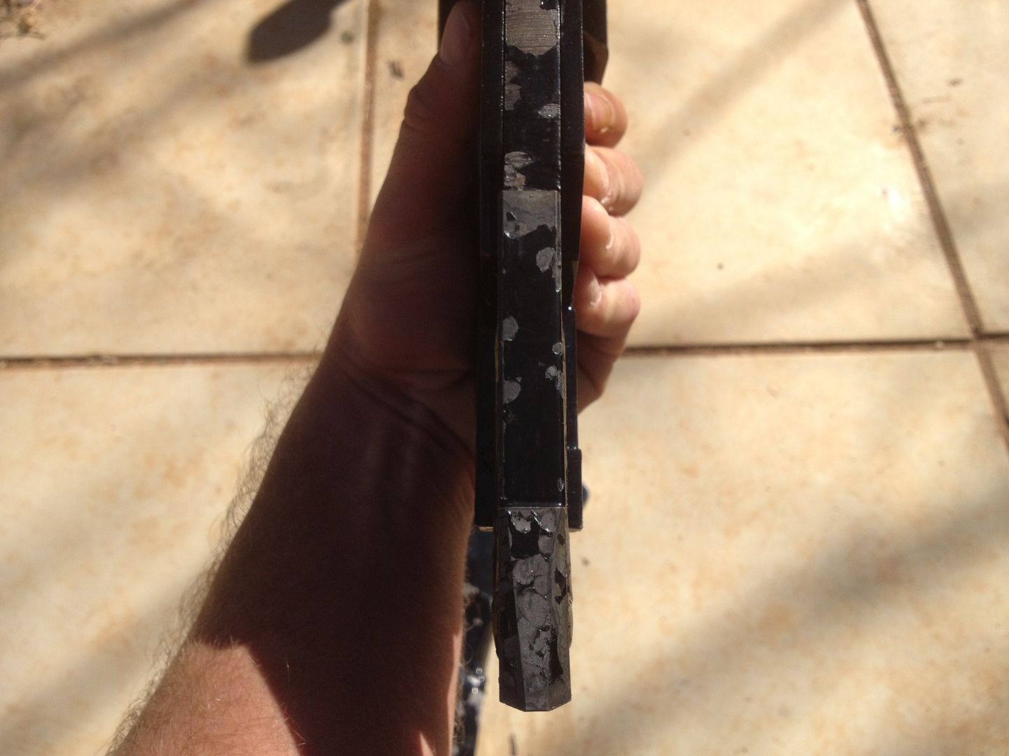

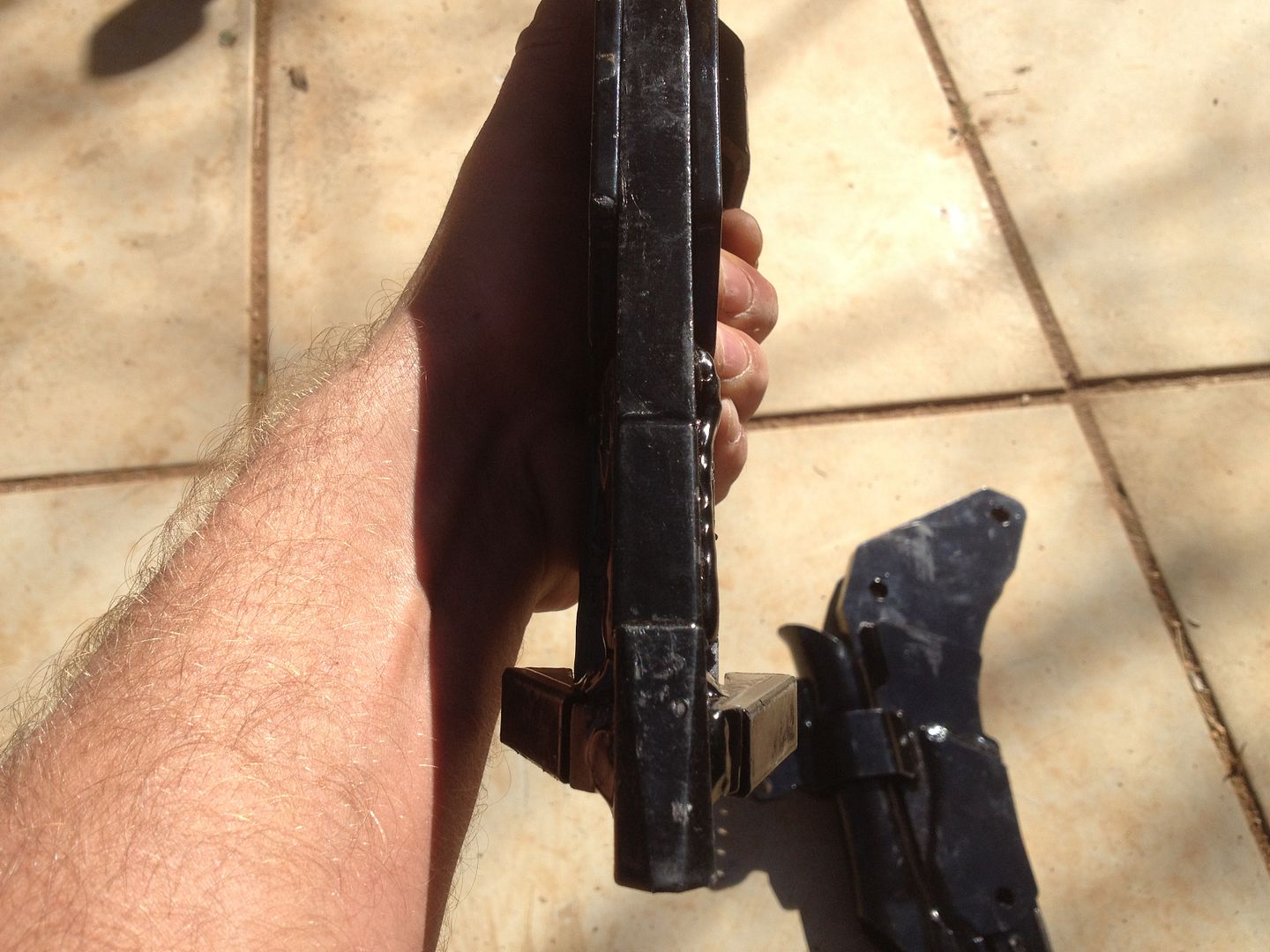

The two pictures below are of the 5in knife and 5in inverted T points. These do exactly the same job as the shorter versions, they just allow you go a lot deeper. They will be great for moisture seeking. The only thing to be aware of is that at the highest depth setting on the row units these points are still putting about 2in of soil above the seed. This is if you are only single shooting with them and not suing a seed boot.
I will most likely get both the long and short versions of the knife point to allow me to plant shallow and moisture seek while just using the machine in single shoot mode. I will have the option to go back to dual shoot if the situations requires it as well. The inverted Ts did a good job as well, they just threw a little more soil (still a lot better than the flexicoil points) and they are sure to use more hp and fuel. Hopefully will have a set on the machine in the next few days and all should be sweet!
